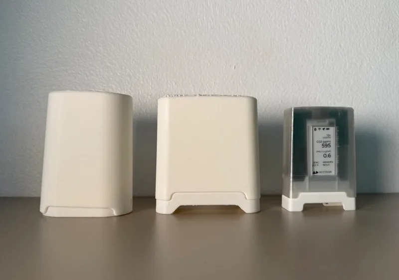

Size constraints - sensors decide the geometry
Iterataions of the AirGradient Go enclosure
You can’t design the enclosure first and then “fit the sensors in later” - the sensors are the enclosure.

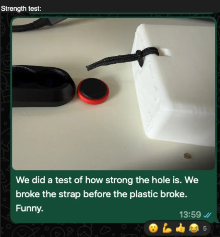

Whatever result we were expecting, it wasn't that the strap would break before the mounting hole!
I always underestimate how much time the “small stuff” takes. Then I build hardware again and remember.
Here are a few details that became surprisingly important:
  • USB clearance: not every USB-C plug is the same size. If you don’t leave enough space, some cables will not fit.
  • Strength around the hanging hole: a backpack mount point needs to survive real stress, not just look good in CAD. The material thickness and reinforcement around that hole matters.
